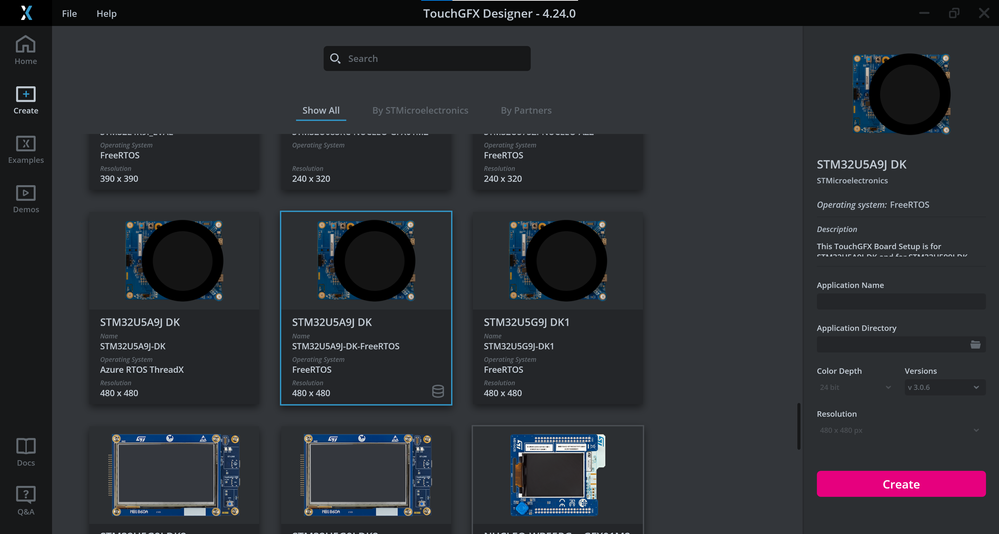

You can get inspiration from the STM32U5A9DK Board Setup that is available in the TouchGFX designer for configuring your board.
STM32U5A9J DK board setup
I hope this answers your question.

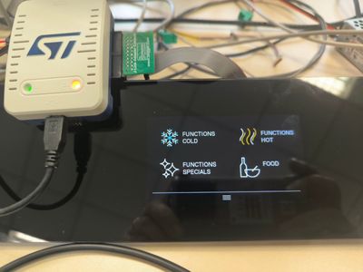

maybe I asked the question too simply
I already have a working project with several screens in a real device
I read in some application notes that the mpu is mandatory, but they talked about cortex M7 not M33
I had doubts whether it should also be activated for the M33
Thanks for you reply.
