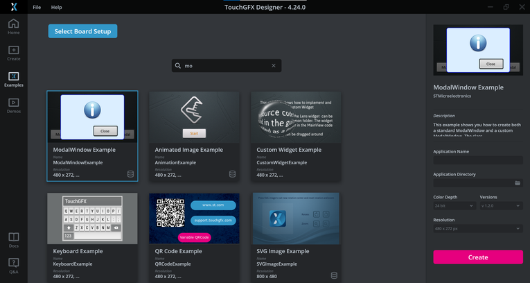

Could you please try a similar implementation to the Modal Window example in the TouchGFX designer to test if the flickering happens?
Modal Window Example
