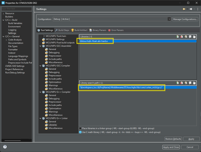

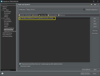

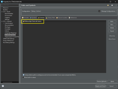

2024-07-22 8:53 PM
You must link with the TouchGFX core library. Depending on your MCU, this would be either
2024-07-26 7:48 AM
Thank you! This solved a similar problem that I was having.
