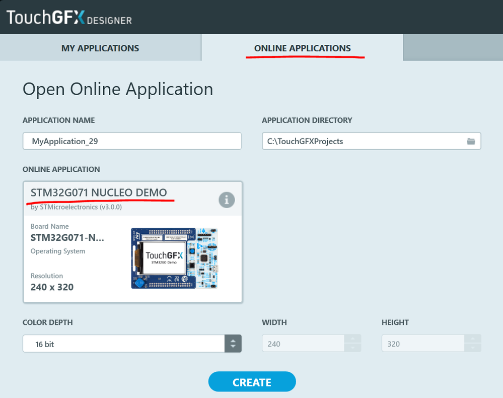

I am not sure I fully get it, what you are looking for is a project where the buttons are used with a TouchGFX project ? If yes, you can have a look at the "STM32G071 nucleo demo" found in TouchGFX Designer when creating a project, in the "Online Applications" section.
/Romain
