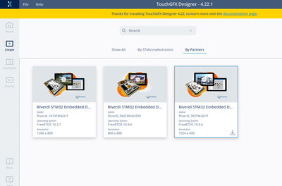

Hello @ngrigoriadis ,
Is your project based on one of these partner TBSs? If yes, the makefile should already be ok and ready for compilation. Have you generated code from STM32CubeMX?
" I need to mention that I didn't got this error before" --> Can you tell us what have changed from before?
2023-09-26 12:51 AM
Hello, I use this partner as you said in order to generate code to the touchgfx. I went to CUBEMX and make some changes like I remove fdcan and other peripherals that I don't want. Although I realize that I should make some changes to makefile in gcc folder. After I did that I overcome that obstacle. Although in touchgfx I configure LWIP and now I need to add this to the makefile because the generated code from touchgfx or the peripherals that automatically is generated don't contain lwip. In conclusion I managed to solve this problem by removing adc hal driver from the makefile and now I need to add to the make the folder that contains all the lwip header files. Can please help me with that?
