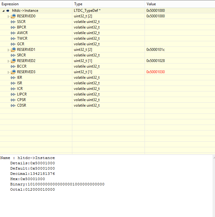

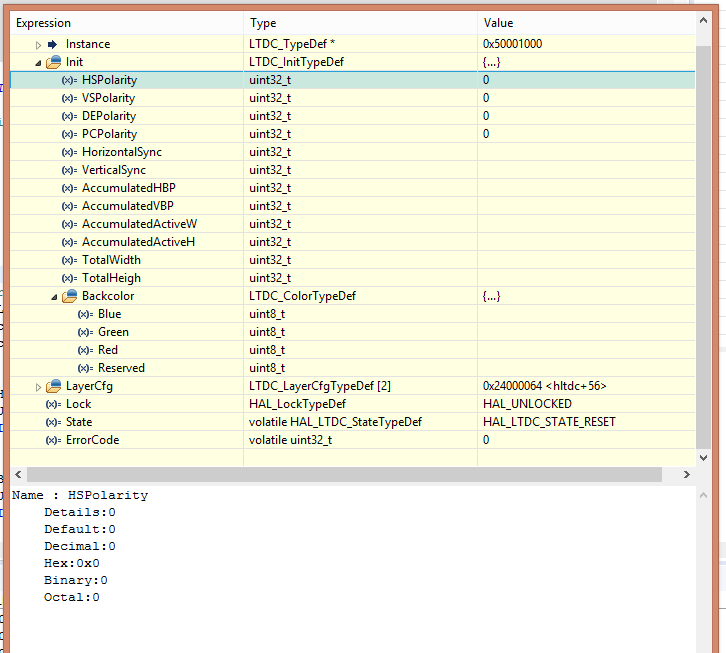

hltdc->Init.DEPolarity | hltdc->Init.PCPolarity);The debugger says this:
So it looks like the Instance is initialized with zeros. But why?
Like I wrote , the code is automatic generated, so I don't delete anythig or write anything into the Init functions.
How can I deep deeper to see what could be the problem?

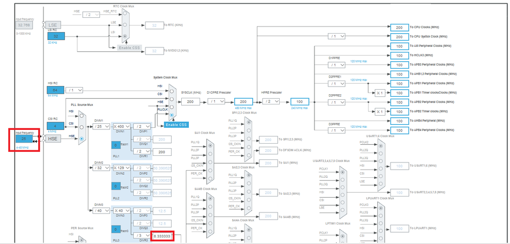

1. My clock initializations seems to be ok. Here is the screen shot:
The source is the 25MHz input clock. The LTDC is getting 8.33 MHz, but this shouldn't be a problem I think.
This constellation works with a blinking LED :)

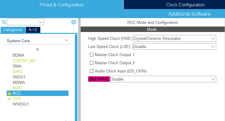

I also get a warning on the RCC because I'm using the 4wire JTAG as a debugg:

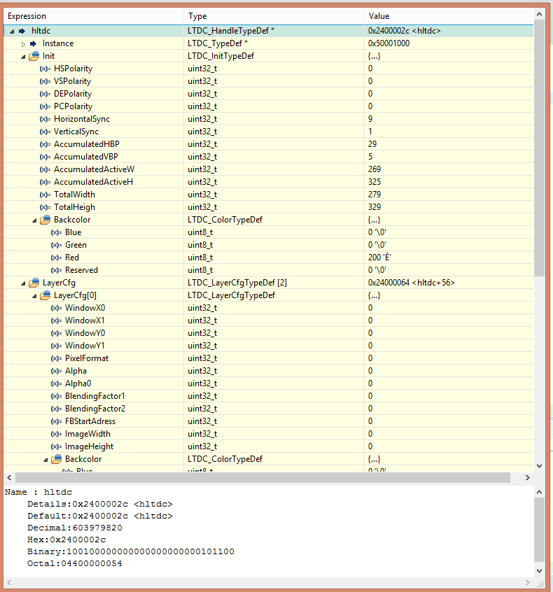

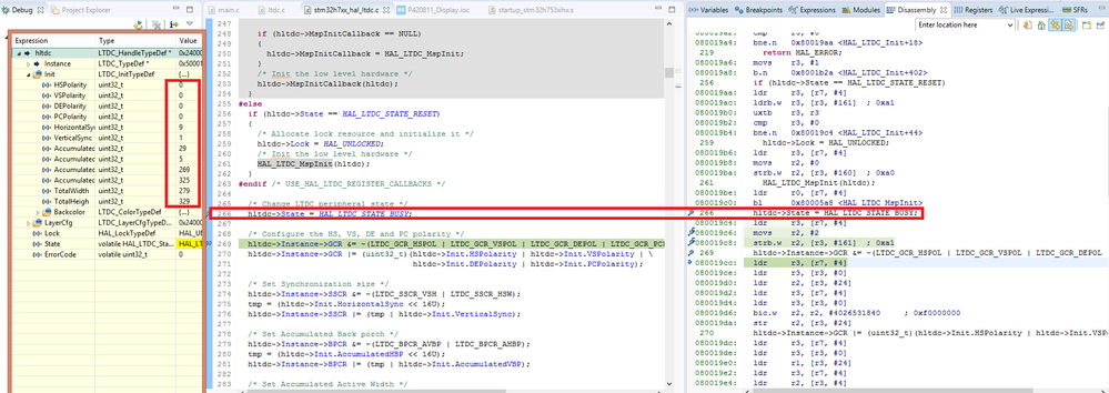

hltdc->Init.DEPolarity | hltdc->Init.PCPolarity);The line 42 is responsible for resetting the initialized values:
/* Init the low level hardware */
hltdc->MspInitCallback(hltdc);
If I debugg one line before that, then I get the following (correct for my display) values:
So I think that the initialization is ok, right?
But when the code gets into the mentioned line 42, then something happens... -> see point 3.

2020-05-13 12:30 PM
Hi!
So I did some stuff and found out that you were right about "And empty subroutine is not clearing your structure."
In this picture you can see that the line 261 was passed and the structure is still there:
But my question is still open: why the actual function, that shall be called in the ltdc.c file "HAL_LTDC_MspInit(hltdc)" is not beeing called?
Instead of it the weak function that is empty...
