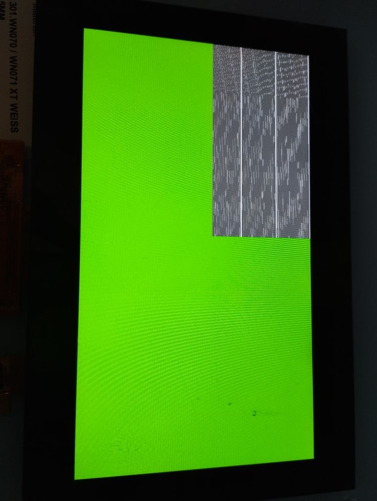

2023-03-06 11:56 PM
It's a custom board, see current display:
(layerCfg.WindowsX1 / Y1 set to 480 / 272 and layerCfg.Backcolor.Green = 255;)

2023-03-07 12:52 AM
So the background works, but the pixels don't? Framebuffer in external RAM? Are you sure that the external RAM works correctly? Passed some RAM tests?
hth
KnarfB
2023-03-07 1:01 AM
I think is located at Flash memory (see screenshot below).... I use example from ST, "LTDC_Display_1Layer"
