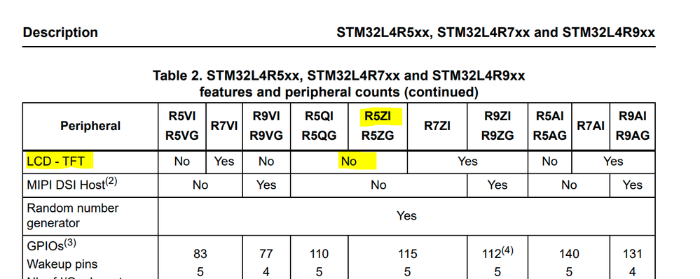

I am following the documentation in application note AN4861 (LTDC) and the data sheet for the STM32L4R5ZI MCU (DS12023 Rev 5). According to AN4861I should be able to configure the LTDC with STM32CubeMX but I am not seeing the LTDC peripheral on the list. According to the MCU data sheet there is an LCD TFT Controller built into this MCU. Anything I am missing?

> STM32L4R5ZI
It doesn't seem that way to me.

2021-08-10 10:47 AM
I stand corrected - thanks @TDK.
