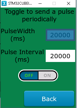

Before pressing the flex button

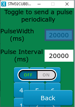

After pressing the flex button

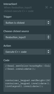

Code
container_keypad.setHeight(269);
container_keypad.invalidate();
listLayout1.invalidate();

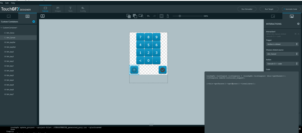

Now I have to close this keypad, I would like to make the button inside the keypad be able to call a function like
listLayout1.remove(container_keypad);
listLayout1.invalidate();But its not working...
My error is either container_keypad not found or Drawable no member named remove
code when cancel button is clicked
touchgfx::ListLayout listLayouta = (touchgfx::ListLayout) this->getParent();
listLayouta.remove(container_keypad);
//this->getParent()->getParent()->invalidate();
