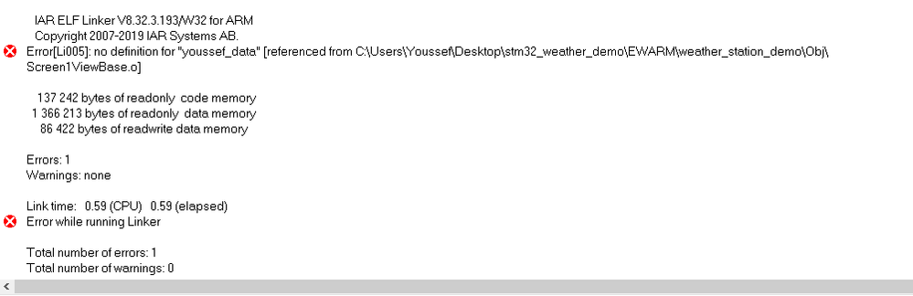

2019-07-18 7:56 AM
Are we sure this is a linker error?
Post a build log, saves playing guess what's wrong.
2019-07-18 8:01 AM
this is a screenshot of the build log
2019-07-18 8:10 AM
Kind of suggests
a) jsmn.c isn't in the project
b) The mixing of C/CPP compilation results in name mangling on the C++ side, and thus an inability to find the symbol
Perhaps use
extern "C" Data_t DATA;
2019-07-18 8:16 AM
a) jsmn.c is in the project.
b) I used extern "C" , but the same problem.
2019-07-18 8:23 AM
The linker seems to disagree, perhaps you need to disassemble the objects and see what symbols are actually inside them.
Not sure if the IAR linker outputs a .MAP on failure cases, or if there are options for verbose output, etc.
2019-07-18 8:39 AM
@Community member
I don't know why but when I add this line (Data_t DATA); in main.cpp the error disappear.
2019-07-18 9:19 AM
I know now what is the problem the Data_t DATA was declared localy on a function in jsmn.c , I declare Data_t DATA globally and I elimineted this declaration in main.cpp
