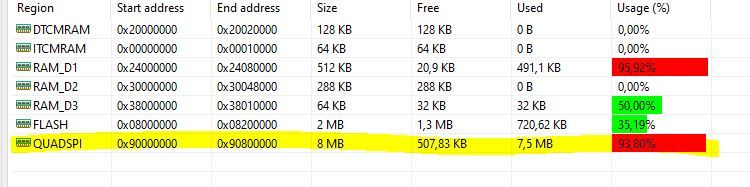

QSPI generally are very big, but sometimes not enough and they can become expensive.
I have a "big" project composed at the moment by 165 pictures and those required about 8MBytes of space.
If tomorrow I will need to add some more pictures i will must to change the memory.
Instead , if touchgfx allow to manage also jpeg files the space involved by graphics contents can be reduce of 50% - 60% (maybe more).
In this case your final graphic will need only 3 or 4 Mbytes, instead of 8MB.

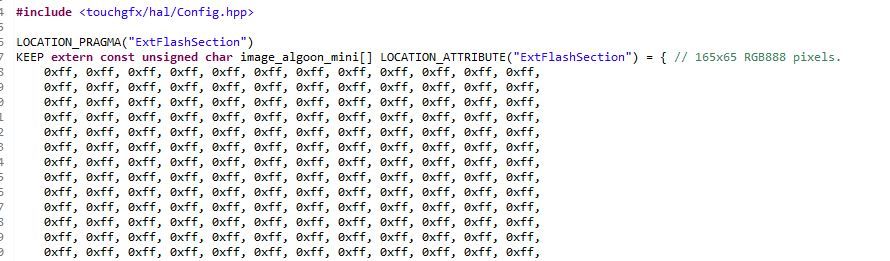

Every PNG image is decoded similar to:
and this is automatically saved in ExtFlashSection (QUADSPI) by the externalLoader when I program the microcontroller.
I think it could be very useful if Touchgfx designer allowed all other image formats to be imported into the project. In this way, all resources can be transferred to the QSPI with a single programming
