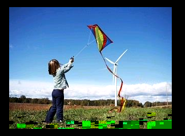

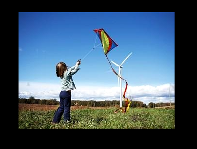

2021-01-10 9:13 AM
with libjpeg or using hardware in polling, mode compression works fine.
but when using DMA image is getting corrupted

2021-01-19 7:18 PM
Check that the memory you use for the DMA buffers is accessible to the JPG block. I had 6 months of grief finding this out on an F7 as by default only the first 128k is in the correct cache region
2021-01-19 7:18 PM

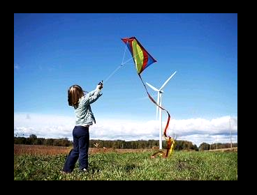

2021-01-20 11:42 PM
Thanks
got it working
I had to put
SCB_CleanInvalidateDCache();
SCB_InvalidateICache();
before dma call and removing this line "HAL_JPEG_ConfigInputBuffer(hjpeg, YCBCR_IMG, 4);" from HAL_JPEG_GetDataCallback
