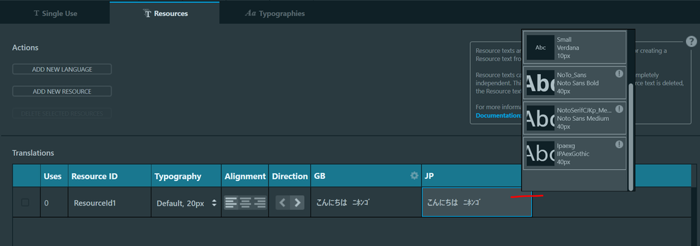

I have tried with Noto Sans, ipaexg, NotoSerifCJKjp-Medium. But still I am getting fallback character. I am using STM32H750VB. Can you please help how to fix this issue.

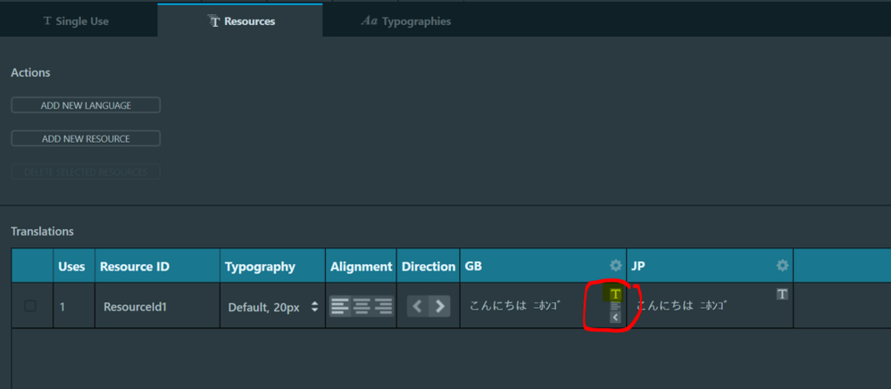

That T icon will let you select the font for that text, I want to make sure you are actually using the fonts handling japanese.
/Romain
2021-06-09 11:43 PM
What is T icon sir? Any screen shots of it. If possible

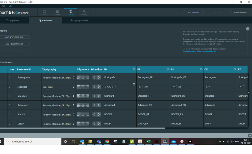

Yes I have done that...

This one. In my previous screenshot you can see the menu it will open./Romain

Yes That one also I made to IPAexg but still in the display I am getting fallback Character.

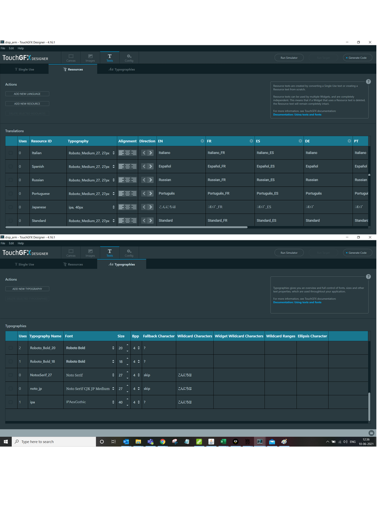

Can you share your project so that we can have a better look ? It is very weird that it works fine on the simulator but not on target. Could you do a full erase of the chip and rebuild the project ?
