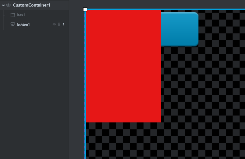

For example, I create 2 widgets (button and box), the box in top and button in bottom.

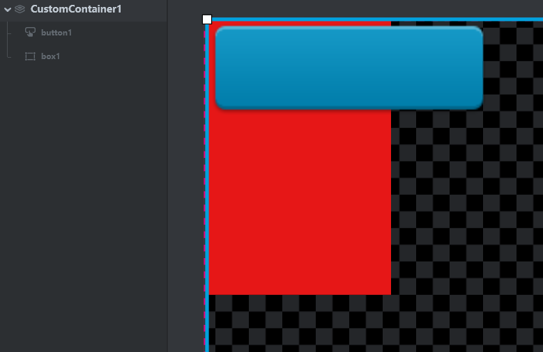

I need to change their position like picture 2, how can I do except delete and rebuild to changed their order ?

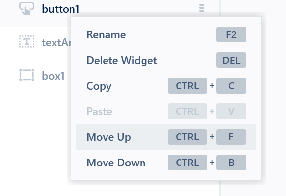

Hello @V.H ,
In the Screens menu, you can simply right click on the widget you want to put on foreground, and then select the "Move Up" option :
Please not that you can also do the same with background, if you select "Move Down".
Hope that this answers the question,
