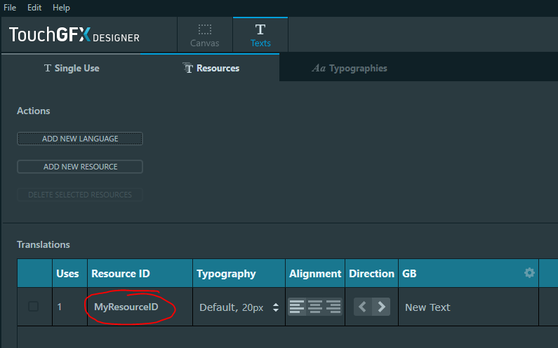

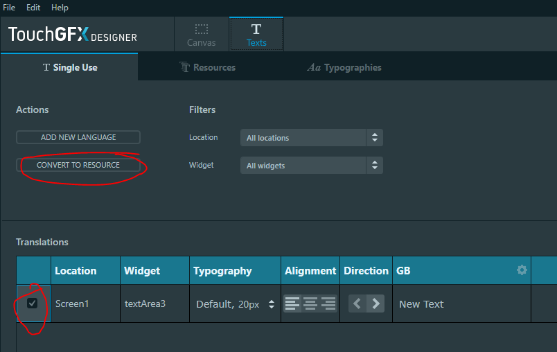

In the Designer, in you go to the Text tab, you will be able to convert text entries which are "single use" to "resources"
For a "resource" text you may choose the variable name for that text resource, also a resource text can be used by multiple text widgets.
Screen dump of Texts -> Singe Use
Screen dump of Texts -> Resources
Looking at the generated code, we see that the resource text now has the ID I have chosen.
generated/texts/include/texts/TextKeysAndLanguages.hpp
/* DO NOT EDIT THIS FILE */
/* This file is autogenerated by the text-database code generator */
#ifndef TEXT_KEYS_AND_LANGUAGES_HPP
#define TEXT_KEYS_AND_LANGUAGES_HPP
typedef enum
T_MYRESOURCEID,
T_SINGLEUSEID1,
NUMBER_OF_TEXT_KEYS
} TEXTS;
#endif /* TEXT_KEYS_AND_LANGUAGES_HPP *//Anders
