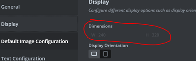

In GfxDesigner I see 240x320 values:
In TouchGFXConfiguration.cpp there is display initialisation:
static TouchGFXHAL hal ( dma, display, tc, 240, 320 );SimConstants.hpp contains
static unsigned short SIM_WIDTH = 240;
static unsigned short SIM_HEIGHT = 320;

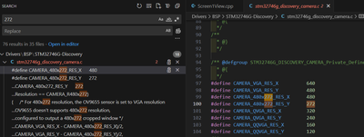

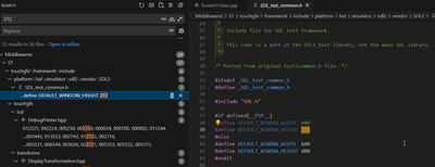

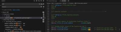

I have found a few defines but they seem to not be used for every project:
ft5336.h seems to be a driver or a library related to the screen used:
stm32746g_discovery_camera.c is clearly related to the mcu:
SDL_test_common.h seems the most promising but I don't know what is PSP and why it is not declared there.
Also, SDL is used for the simulator :

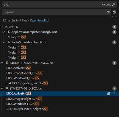

SimConstants.hpp is generated by TouchGFX and accessible "in his scope" so this might be your best bet.
Since it is a static unsigned short, can you use it in your expression?
The value is also available in the .ioc and .touchgfx files:
I hope this helps you, I am not sure what you need.

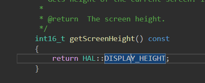

Hello @ferro ,
You can use getScreenHeight() and getScreenWidth() (no need to put anything in front of those methods).
See : classtouchgfx_1_1_screen
Regards,
2024-06-18 6:02 AM
Thanks @GaetanGodart ,
this is close but not enough.
>"no need to put anything in front of those methods"
This is true only when within methods of a gfx::Screen derived class or having an instance of it.
Implementation of Screen::getScreenHeight () looked promissing
however, it is a variable
So cannot be used with compile-time expressions e.g.
static constexpr int DisplayNumberOfPixels { HAL::DISPLAY_HEIGHT * HAL::DISPLAY_WIDTH };
Best,
