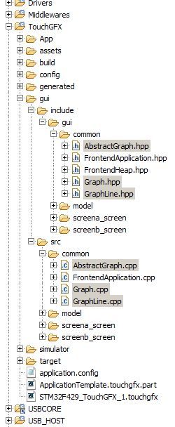

The picture shows it in my STM32CubeIDE.
Then you only need to edit your ScreenXXXView.hpp:
