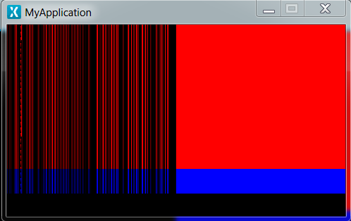

I did do some testing based on your post about the painter's render function (not using RenderingBuffer and Rasterizer which I mentioned above). I was able to paint a shape into a dynamic bitmap and display it, but it is not quite right. It has a number of vertical lines through it so I probably have something wrong with the increment of the pointer or possibly the "covers" parameter.

Below is a screenshot of it running on the Simulator. I made the shape visible for demonstration purposes. The shape uses the 240x240 image on the right. The Image widget using the Dynamic Bitmap is on the left.
I see that the Drawable class has a function drawToDynamicBitmap(), but assume that doesn't blend, and simply copies it over in the Dynamic Bitmap's memory?
