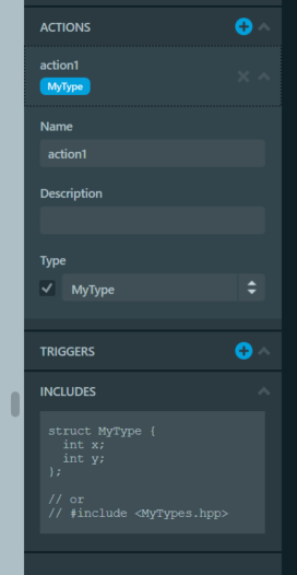

What you can do for now:
Instead of having an action/method with two parameters, you could create an action/method that expects one struct parameter.
In Designer an example definition would be:
And an example usage would be:
Hope this helps.

@scottSD Your input is really appreciated. We would like to make this more obvious.
Hope this helps.
