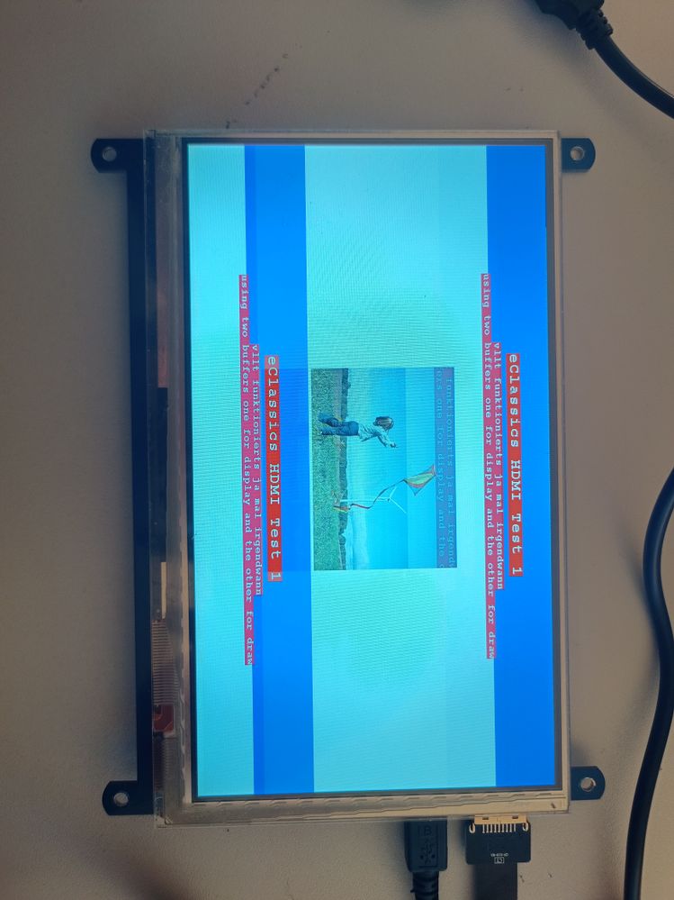

The examples provided by CubeF7 are also not running perfectly since the Screen is flickerung and the Image is shown two times (one is moved about 1/4 inch towards the Bottom.) Is there a way to adress those two issues?

I found a few issues, but the Image still gets drawn several times.
I used a Video-timing-calculater to set all the values like Front/Back-porch and so on, but I can´t find a way to get rid of the described problem.
I am running the example Programm with two image-Buffers.

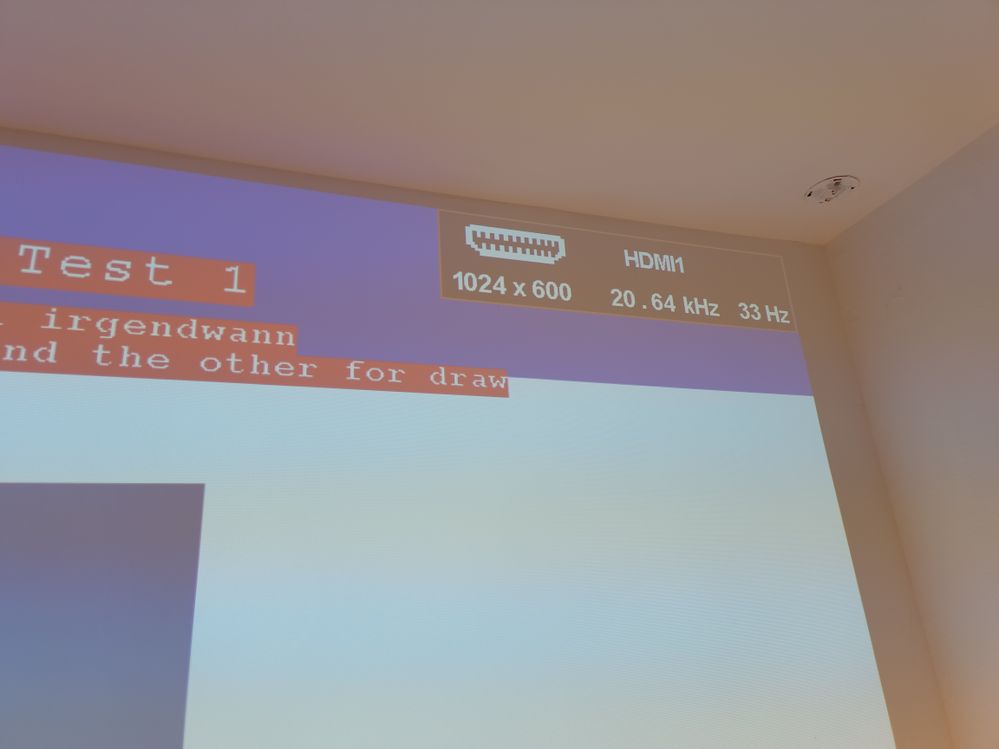

When I connect the board to my projector, I can get a bit information about the Signal maybe that helps identify the Problem

I have one problem sorted out, the Image-Buffer did not have the right size. Now, the image gets shown correctly. However, it looks like everything has a light shaddow a few mm underneath the real image. Does anybody have an idea on hoe to change that?
@ Tesla Delorean, How can I change the Hz of the image? In the example you kindly provided, it is set to 60hz, but in my programm I can only get it up to 33Hz.
