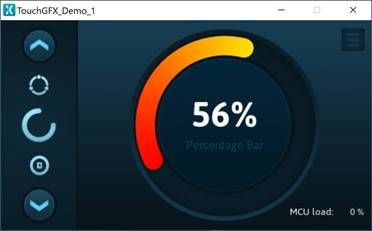

I was wondering if anyone have made a 'rotary-style' button, like a rotary encoder or a volume knob that can go on-screen?
I suspect it would involve resolving a touch input and mapping it to some sort of circular motion or something like that. A rounded slider would also be of high interest!
Any inputs would be appreciated! Thanks!
2020-05-28 3:52 AM
In Demo 1 you have an example of a circle progress bar that you manually increase and decrease, I suppose this is what you are looking for. Look at the CircleProgress.cpp and hpp files to have an understanding of how it was implemented.
/Romain
2020-05-28 3:52 AM
/Romain
2020-05-28 8:18 AM
Beautiful! Thanks, I knew I had seen something like that somewhere :D I'll dive into that code now!

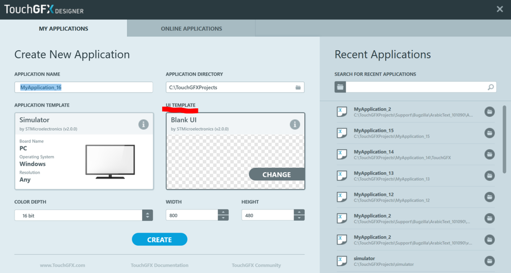

2021-02-11 3:41 PM
I am interested in this demo, where I can find it?
Thank you in advance for your reply.
2021-02-11 11:36 PM
This demo is available when you create a project in TouchGFX Designer under the "UI template" section.
/Romain
2021-02-12 11:57 AM
It's the perfect example I'm looking for, thank you Romain.
