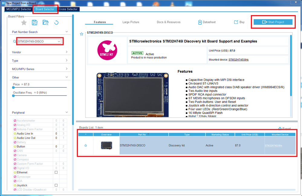

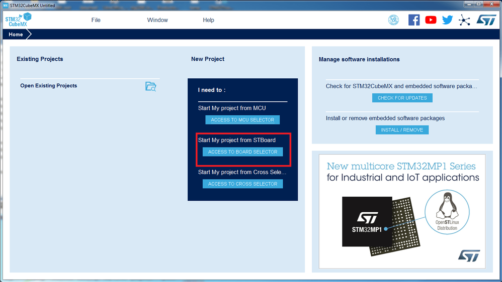

1. Open "STM32CubeMx" and click on "ACCESS TO BOARD SELECTOR".

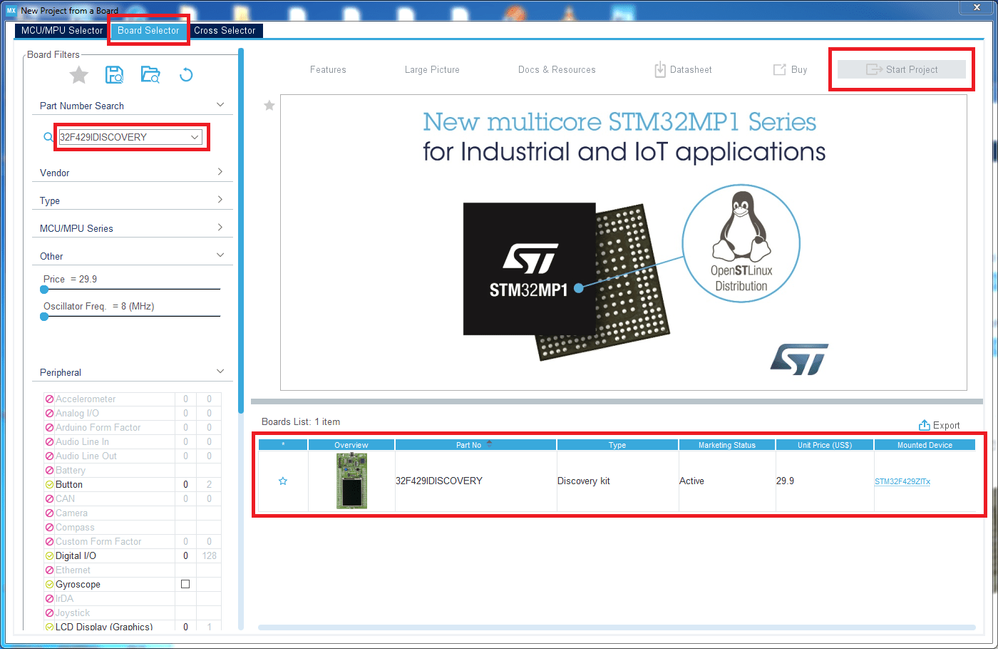

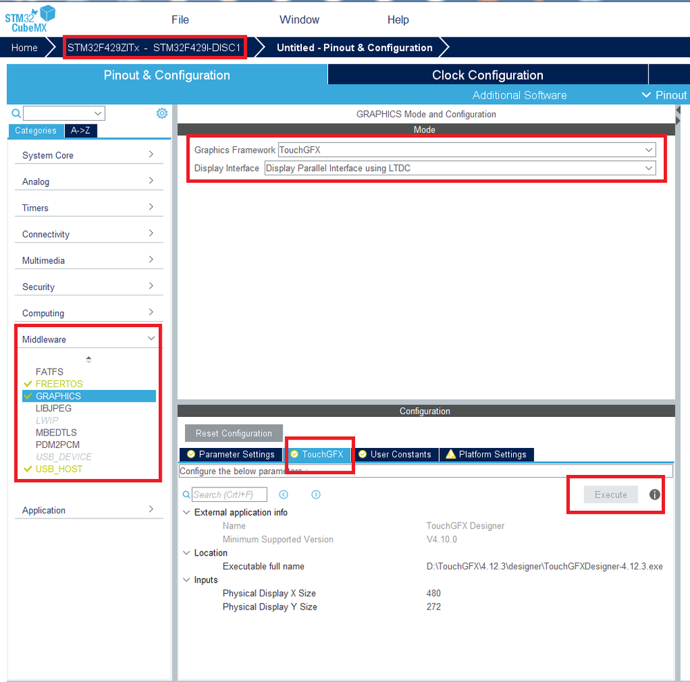

2. First, I am choosing the "STM32F429I-DISCOVERY" board, where I can find the "GRAPHICS" Option in the "Middle-ware" TAB, so I can able to choose the "TOUCHGFX" as Graphics Framework. please find the below snapshot.
3. Close the "STM32CubeMx" and again open it.

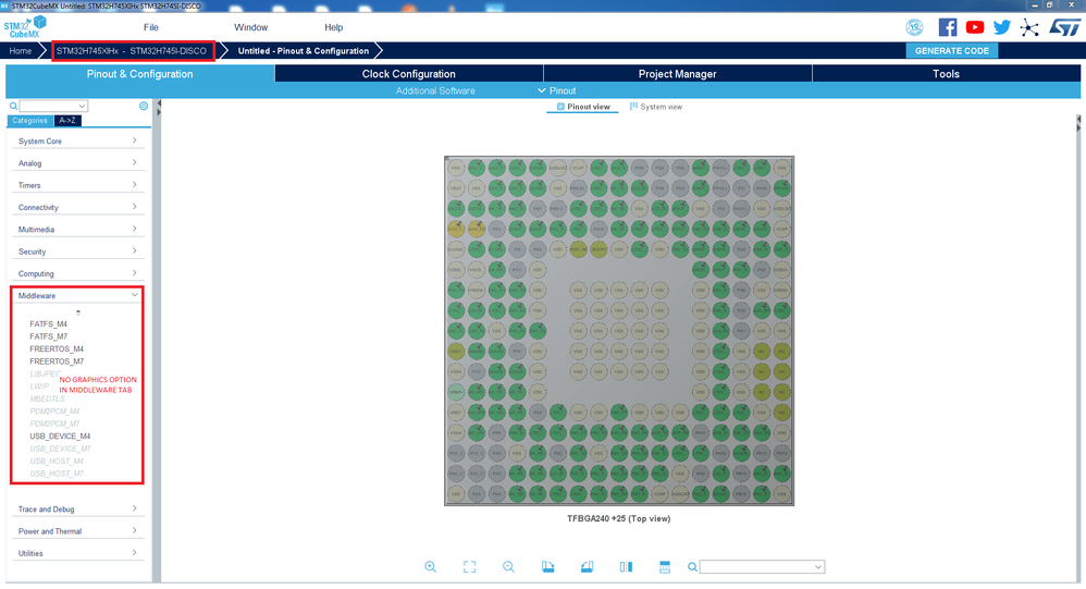

4. Now, I am choosing the "STM32H745I-DISCO" board, where I can not find the "GRAPHICS" Option to works with "TOUCHGFX". please find the below snapshot.
Let me please clarify it.
