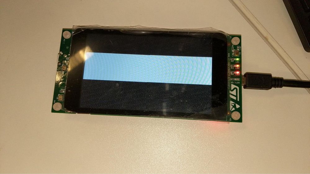

Now, I am able to compile my code :) but the display is not working properly (PFA the image). If I disable the led_task, the display works fine (without hw integration). I even tried disabling the code inside the led_task but the issue is persistent. I don't know if it's something to do with the Makefile. PFA my project for reference.
2019-06-17 11:36 PM
You may have forgotten to program the external flash :)

2019-06-18 3:26 PM
Could you try adding some Boxes that don't require external flash, just to test this theory. Make them draggable. Just to see that you have a working application.
2019-06-20 9:21 AM
I made a new application with just a draggable box and it works. Also, as I mentioned earlier, when I remove the led task from main.cpp file, the application works fine (In this case the gui button is not able to control the led on board as the led task has not been created).
