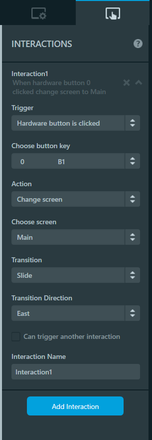

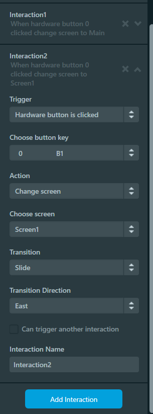

Now, I want to use USR_BTN ( only single button ) key for screen transition. I have add two interactions in TouchGFX Designer.
For that I have made two screens, and want to change screen whenever USR_BTN is pressed.
For example: Currently, I am on Screen1 and press the key then screen should be changed to Screen2 and vice versa.
But whenever USR_BTN key is pressed, screen is not transitioned smoothly. LCD will flicker for some time. I want smooth transition in between. What should I do for that?

Even if I want to change Screen1 from Screen2 using external button it is working fine. But I want to change from Screen2 to Screen1 using same button.

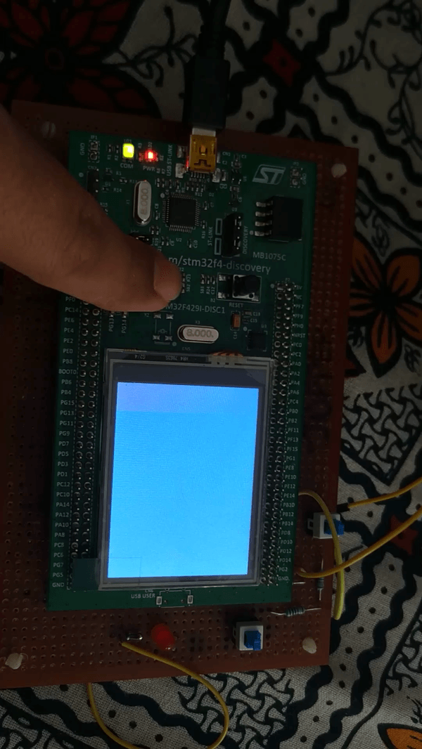

I think that multiple times events gets registered and due to that LCD will continuously back and forth in Screen1 and Screen2. So it looks like flickering.
I have to add some delay or wait mechanism to correctly detect the button is properly pressed.
There is no option in TouchGFX for that. How will I do that?
Attached GIF for reference.
