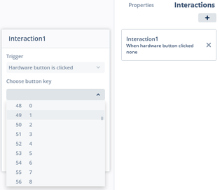

When you are using the ButtonController class, as it seems like you do, hardware buttons can be handled in the same way as buttons in the GUI. So, if you want to trigger an event on button "1", create an interaction and select "Trigger: Hardware button is clicked" with button key 49, which corresponds to "1". Then, you have the same actions available as you have for GUI buttons.
