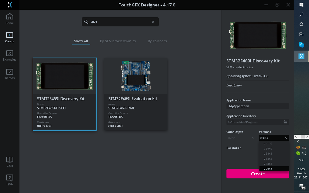

SOLUTION FOUND
After long chat discussion with MM..1 and TeamViewer session we came to conclusion that Touch Designer 469-Disco projects of version 3.0.5 ARE BUGGED, 3.0.4 works OK!

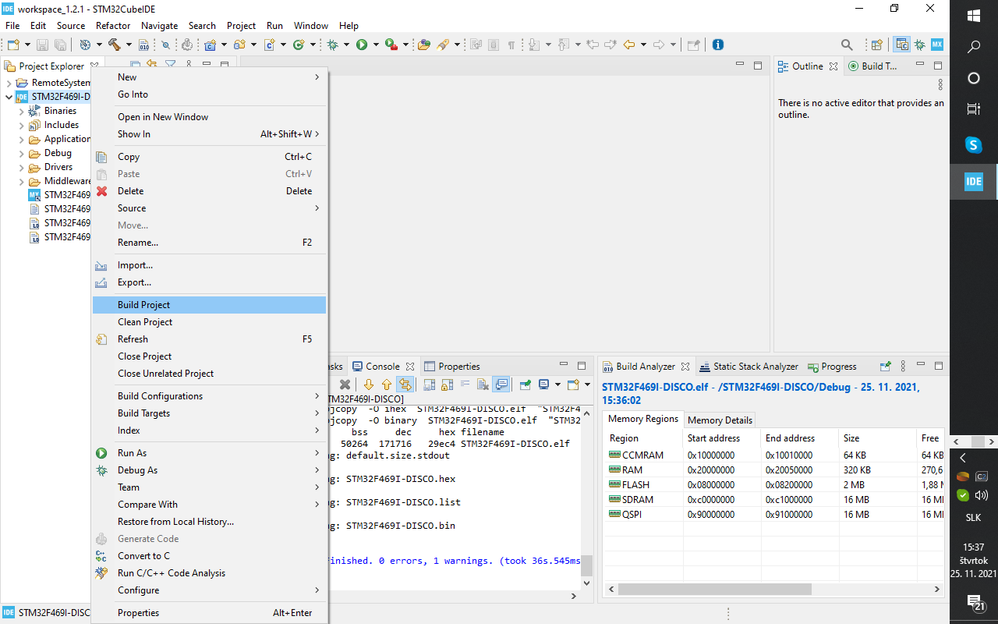

Maybe you missuse build button on tools bar green. For beginer is better use as on my image right mouse click on project line in project explorer, and use Build Project as on image. Select project line before build is important .
I use TouchGFX 4.17 and IDE 1.7.0
And too workspace maybe need delete same name projects when you plan open next try with same name...
