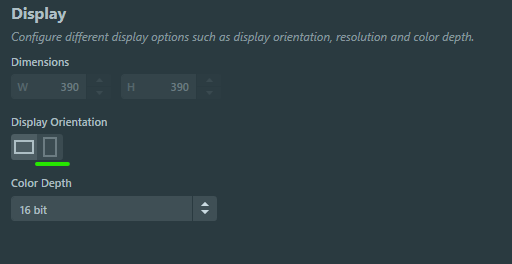

I am trying to implement a product that needs to swap between landscape and portrait mode of the same screen dynamically during run time.

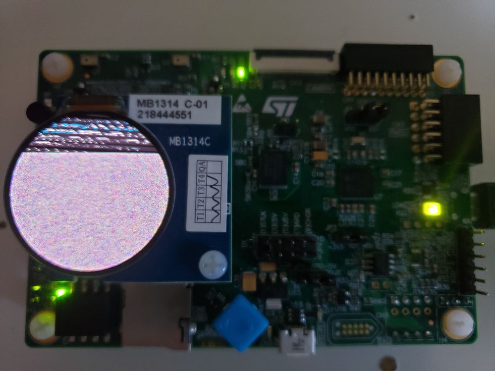

I am using TouchGFX designer 4.16.0 with the TouchGFXWatch UI template to do some basic tests. When I run the target in landscape mode it works as expected. If I change it to portrait mode, as shown below, and run it on the L4R9I_DISCOVERY I get unexpected results as shown below (which is the same result I get from my code base).

I should only need to rotate the images in TouchGFX Designer which the Display orientation radio buttons do.

When I run setDisplayOrientation, during run time, in my code base and in the example code bases it results in the heavily offset display as shown in the second image I posted.
On round display and maybe your code is used MMU for memory round and here maybe need you more changes in target code too , i recommend here dont waste time, you set only one orientatioín and in code rearange objects XY and angle...
