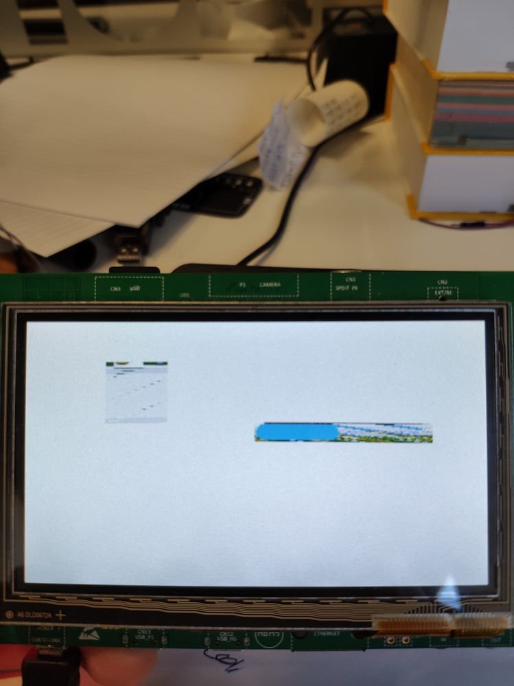

In my project I am using many images as assets , some as a logo others just a background for a button.
However, when I compile the project through Keil, the images appear weird and noisy.
In the other hand when I compile the project through TouchGFX (GCC). The images are displayed correctly.
Example:

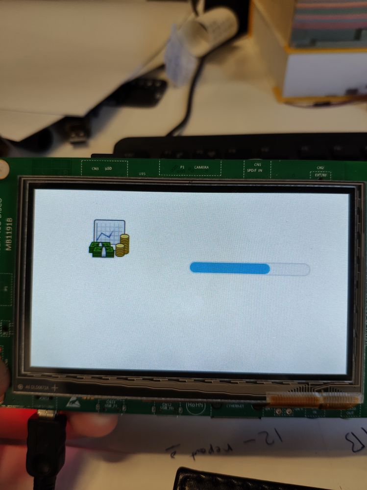

Here is the screen when compiling through TouchGFX Designer (GCC):
Here when compiling through Keil:
Any solution to let Keil compile correctly ?

2019-07-01 6:33 AM
Hi, I think you need to reprogram the flash. The Keil project does not support a flashloader for the QSPI (Where as the TouchGFX project calls ST-Link behind the scenes).
/Martin
2019-07-01 6:37 AM
How can I do this exactly ? would you please explain more

2019-07-02 12:00 AM
Hello Martin
first I would like to thank you for being very helpful and answering my posts since I start working with TouchGFX.
Coming to your answer, as far as I understood. I need to load the hex file created from building the project using St-Link utility.
I just tried that, I am getting an error saying "no ELF loader found for this operation".
2019-07-02 12:03 AM
Ok, so I added the external loader option before starting programming the .hex file.
Now everything works fine and the images are displayed correctly.
