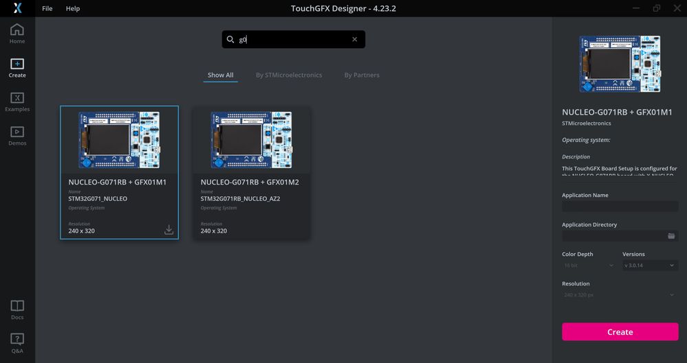

Hello @SafeDev ,
No, you don't need to separate them into two different binaries. You just need to dump both sections into one .elf file. As a reference, you can take a look at the Board Setup available for STM32G071RB_NUCLEO on TouchGFX Designer. There is a similar setup for having Fonts and Images on the SPI Flash.
STM32G071RB Board Setup
I hope this helps you,
Good luck
