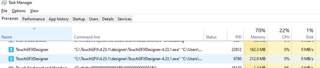

When I close GFX Designer its window disappears, however, the TouchGFXDesigner-4.23.1.exe stays running in the backround - for every opened/closed *.touchgfx project.
Does anyone experiences this GFX misbehaviour ?

2024-02-12 8:21 AM - edited 2024-02-13 12:52 AM
Sorry for my slow reply @Mohammad MORADI ESFAHANIASL
> "Or when you open a previously created project?"
Yes, it happens every time I open the same project.
