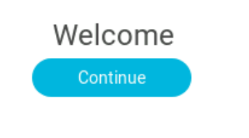

For the application I am building in TouchGFX, the image and text quality is very good and crisp in developed screen. However, the quality/resolution is not retained in simulation. Below are the before and after pictures.
In this picture, both the "Welcome" text and the button label "Continue" are very crisp. This is from development screen in TouchGFX.
Picture below is from simulation window. As can be seen, both the texts are not as crisp as above picture. This loss of quality is observed with images too (compare the blue button image itself).
Please advice what settings I might be missing.

Hello @BGuth.1 ,
Have you fixed your issue ?
By default, TouchGFX should work perfectly on simulator.
Maybe as indicated by MM.1, your computer does not allow the right resolution for the simulator application of TouchGFX. I've never encountered this issue and I used TouchGFX on many computers so I cannot tell you exactly what is wrong. It can be your display scaling.
Try to search on Google about "low resolution issue on some application on Windows".
/Alexandre

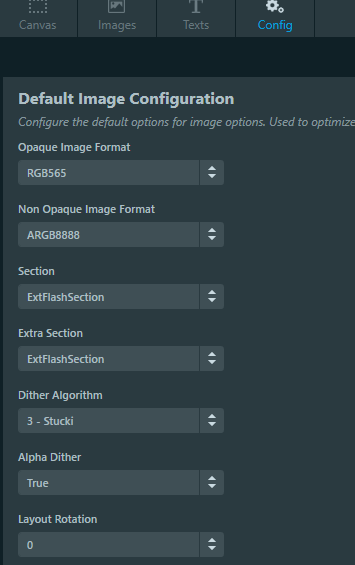

well, I met the same problem like you do.I just wrote a programe to transform the source image to cpp arrary and found some differences. Then I replace it with my the generated array, but it made no changes. I don`t know what to do ,maybe hardware config problem. If you make it ,tell me please.

I think I have solved my problem now, I add the my own LTDC init function after that Cube generated and it excutes twice, I remove my own fun and it run well.You can check you pix format of touchgfx and MX configuration,also the RGB IO pins.

May I know what pix format of touchgfx are you using?
What MX configuration are you using?

Well, my pixel format is RGB565 and resolution is 800 x 480. So the color depth is 16bits.Maybe you can check this..

Hello @BGuth.1 ,
/Alexandre

It seems it is my computer. I finally go the target board and graphics looks fine on LCD. I was concerned if it was going to look the same way as it looked on my computer.
