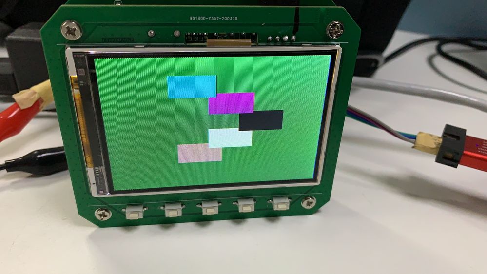

I used partial frame buffer + FSMC.A strange thing happened to me.Any monochrome can fill an entire screen.But if you use more than one color, GFX will no longer fill when it encounters another color.
Did I do something wrong?

Have your lcd internal full framebufer gram?
2020-07-29 12:24 AM
Thank you very much for your answer.
Yes there are.
The problem of not being able to fill the entire screen is now resolved.

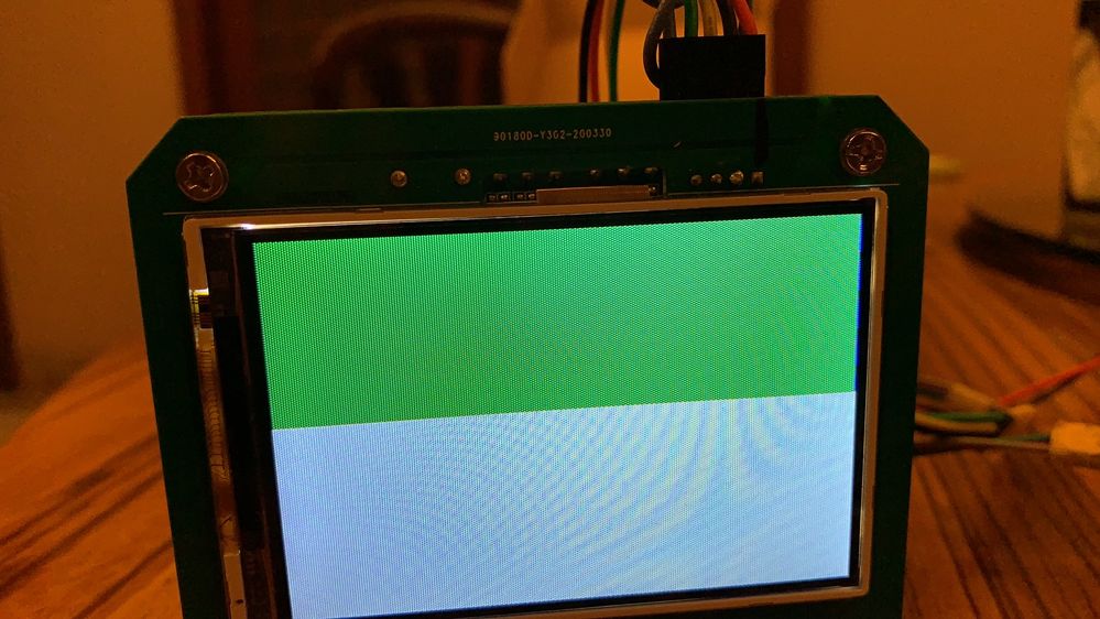

Now there's a new problem. The image seems to be stretched.

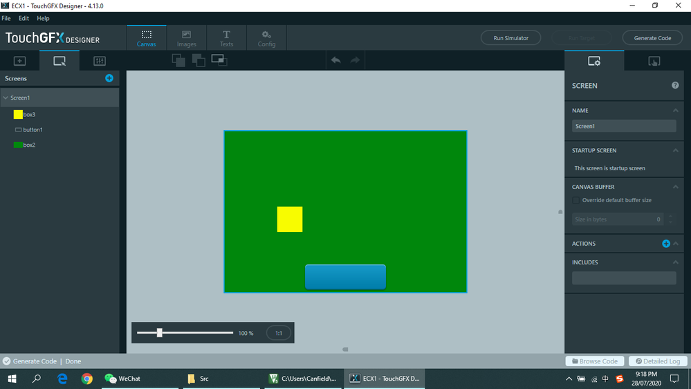

And only half of the images in the designer are displayed.
I noticed the comment "//Change to SPI datasize to 8 bit from 16 bit".
Can only use 8 bit data transfer? I'm using a 16-bit data transfer here.

And the other thing that's odd about it is, whether it's portrait or landscape.The screen can only display the first half of the canvas in the designer.Both the screen and GFX have 480 x 320 resolution.
