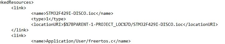

2022-06-25 1:29 PM
Hello , Yoann KLEIN (ST Employee) , i've tried to add a link to .ioc file in .project , and its added a .ioc file in cubeide , but i can not open this file , also it is not visible in folder from a windows perspective . There is a photos what's happening while trying to open .ioc file and a .project file with added part of a code which is adding a link to .ioc
