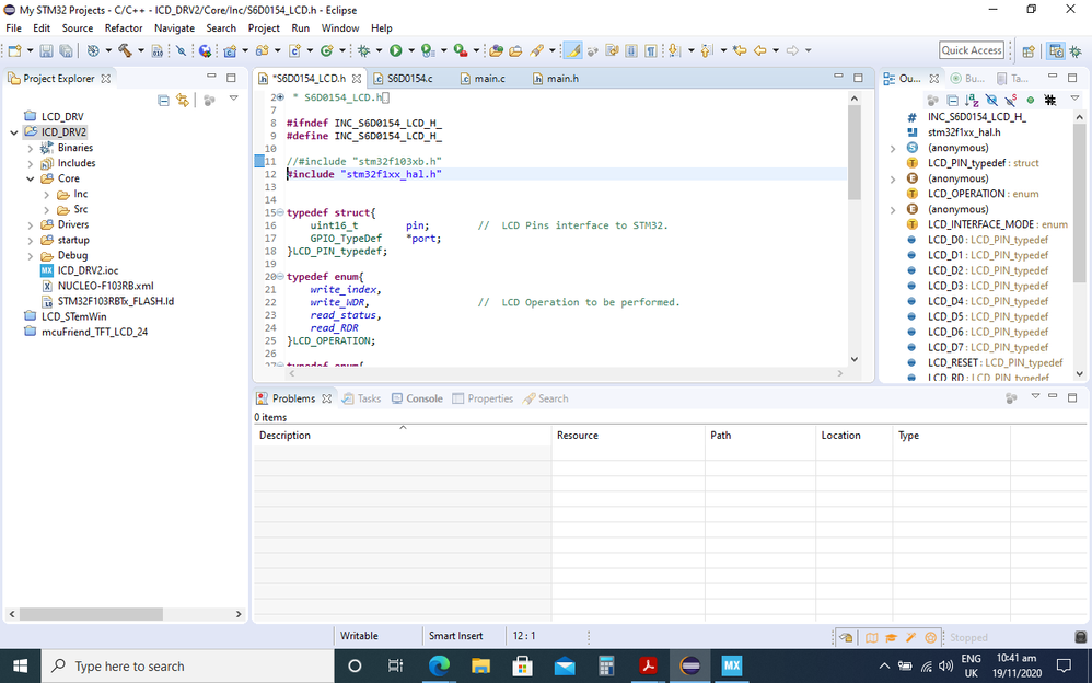

2020-11-18 9:44 PM
Including #include "stm32f103xb.h" in S6D0154.h produces symbol'GPIO_Pin_0' can not be resolved semantic error. Including #include "stm32f1xx_hal_gpio.h" resolve these errors in S6D0154.h file but compilation is not successful and strange errors appear in Core/inc folder. Instead of including stm32f1xx_hal_gpio.h I included stm32f1xx_hal.h file in S6D0154.h, now all the errors in S6D0154.h files cleared and project compiled successfully without any errors and warnings.
For me this was a fluke, Kindly give some guideline regarding including .h HAL files, (as I included stm32f1xx_hal_gpio.h to resolve "symbol'GPIO_Pin_0' can not be resolved semantic error", which resolved issues in .h file but project not compiled)

Actually only stm32f1xx.h must be included in code and STM32F103xB and USE_HAL_DRIVER must be defined globally.
