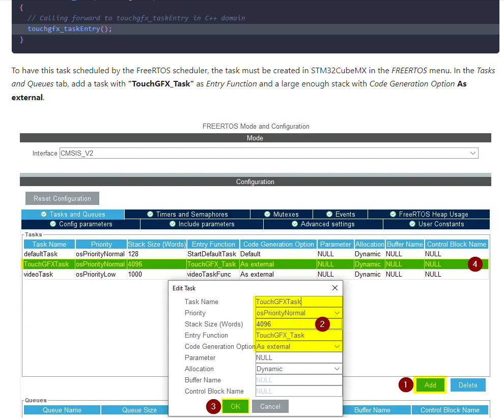

I've enabled FreeRTOS and have two tasks enabled, one blinking an LED that is working. The other set up for TouchGFXTask like the instructions.

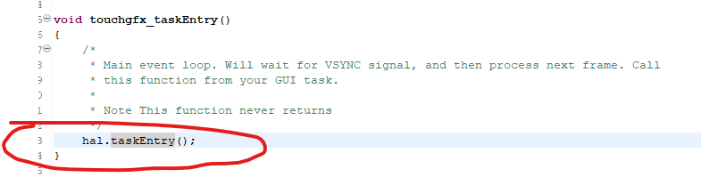

Which creates the task, I can follow it into app_touchgfx.c, and on to TouchGFXConfiguration.cpp
The hal.taskEntry() takes me to HAL.hpp. No where else.
Looking at another example the hal.TaskEntry() goes to TouchGFXHAL.cpp and has code:What should be at hal.taskEntry()?

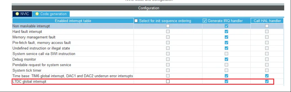

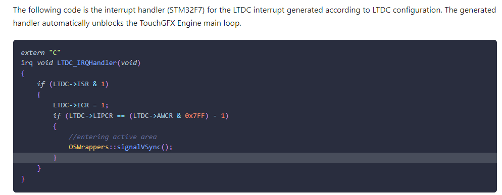

The instructions also reference the LTDC_IRQHandler again. I don't find this section of code below anywhere. Should I add it and if so where? Now that I have enabled FREERTOS, the LTDC_IRQHandler in stm32l4xx_it.c doesn't get raised.
here:

NVIC is enabled like the screen shot below. The interupt was getting called before I enabled FreeRTOS.

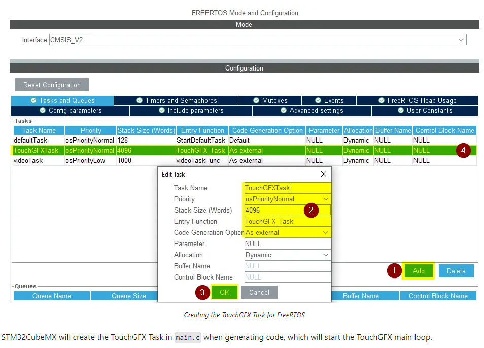

After I setup FreeRTOS like this:
I can drill into the task it created,
to hal.taskEntry(), there is no code / function for hal.taskEntry(). Shouldn't TouchGFX have generated the code?

Follow up on the 4.21.1 version: I increased the RTOS Heap to 40k and the task stack size to 5000, then the display worked. I tried to figure which change made the display work, and set the heap back to 30k and task stack size to 4096 and the display still worked. This is the same project and version that didn't work a couple of days ago. The only other significant change I made between then and now is I installed 4.21.0 to see if the display would work with 4.21.0. After I verified 4.21.0 worked I made the heap and stack changes to 4.21.1. I don't remember making any other changes to that project. I was hoping to narrow down the change that fixed it, I'm not sure if 4.21.1 needed something that was installed/updated by 4.21.0, or something else changed that made it work?
