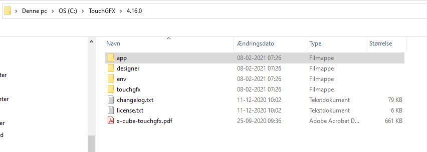

I'm a newbie, so please be gentle to me :-) Installing TouchGFX at default location. But testing out just simulator doesn't bring up the simulator window. Why could that be? Cheers Bent

Noerrors, but still no window with graphics. Is it relying on java or something else, that it doesn't install by itself?

I can't find any simulator.exe file.
