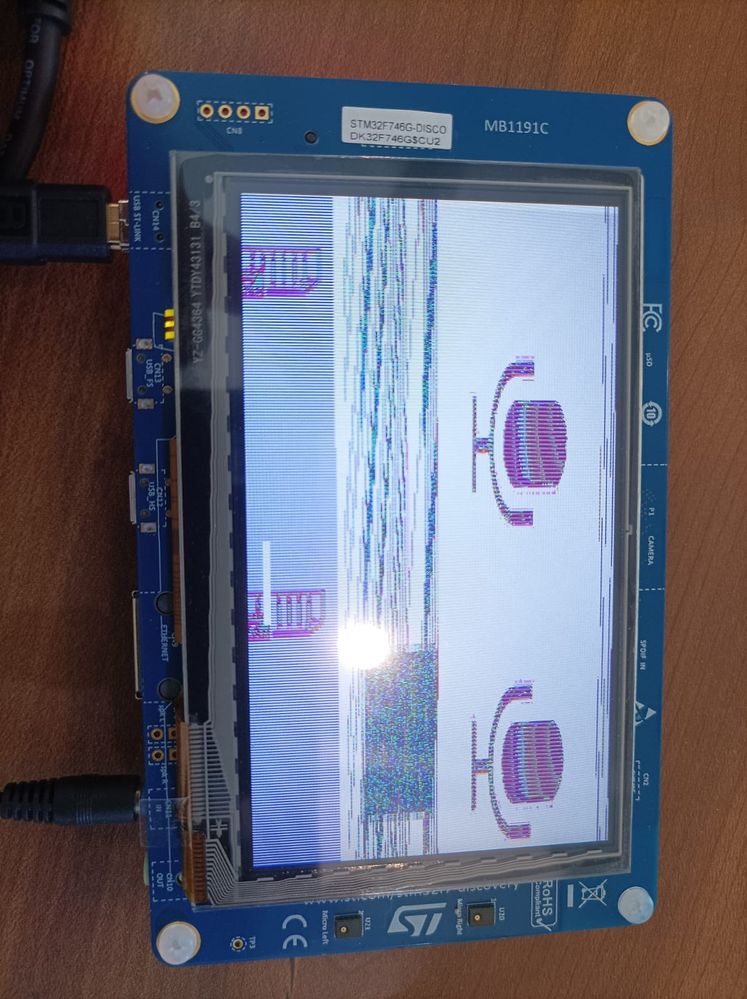

Please try Checking the Display Colors to make sure that your display colors configuration is correct.

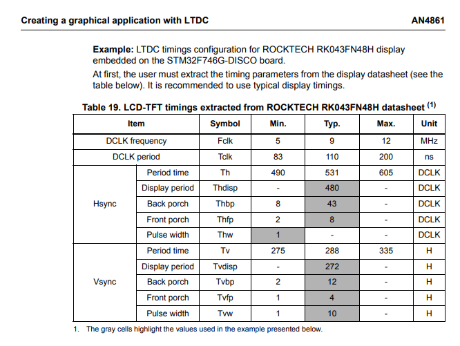

You can also check your LTDC configuration from the AN4861 (LTDC parameter/layer settings, LTDC clocks and timings configuration...).
