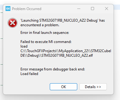

Show steps to recreate... How you import into IDE?
Check external loader setup in IDE debug config...

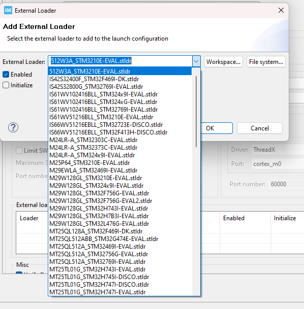

Finlay figure it out thanks for the pointer,,,MM..1
Added MX25L6433F_GFX01M2_STM32G0.stldr to External loaders...

Hello PEkbe.1,
What you did is correct. All ours TBSs based on X-Cube-Display module (STM32G071 AZ1-AZ2/ STM32WB55 AZ1-AZ2, STM32U575 AZ1) need a specific external loader which is not provided by default on STM32CubeIDE and this is why we need to add them manually by copying it to the installation folder.
I've found another thread which treats this issue actually, I'll invite you to have a look at it.

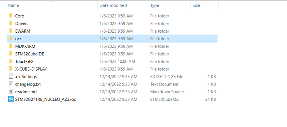

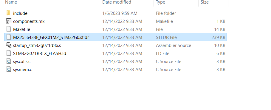

Hello PEkbe.1,
This external loader is included in the TBS itself in the gcc folder :
/Osman
