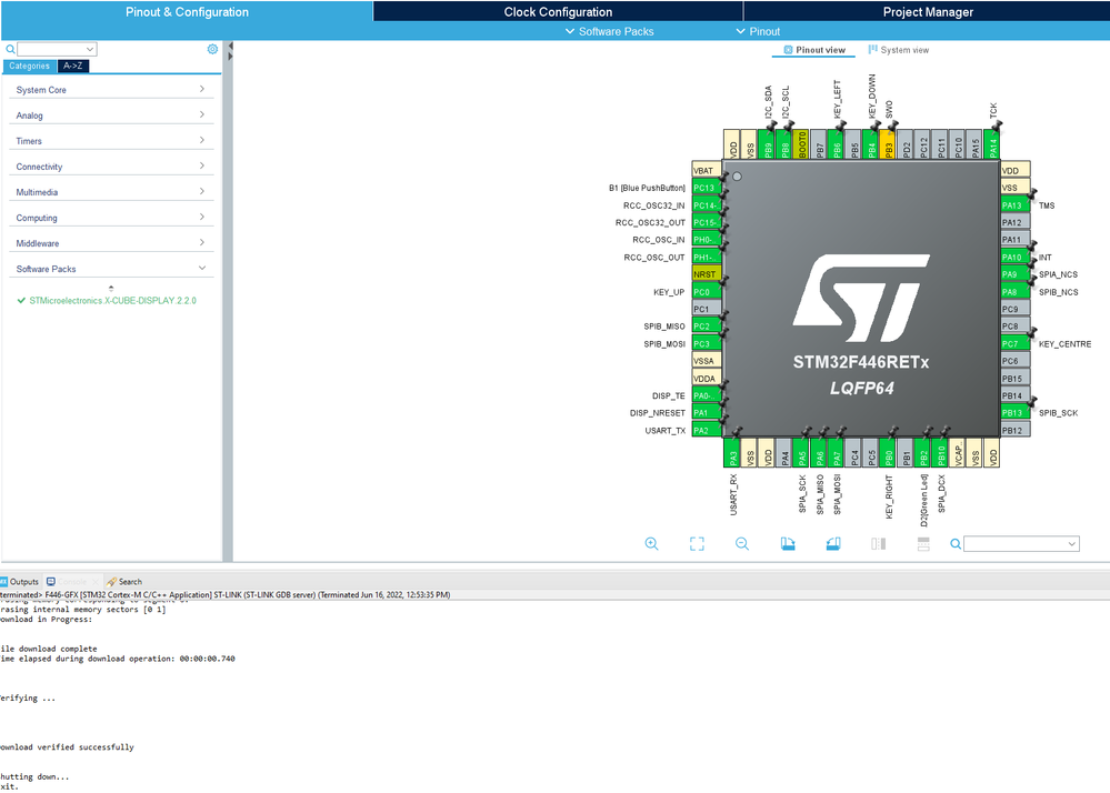

I'm using STM32CUBEIDE and have configured the pins as per UM2750, shown in the image below, all seemed good. I incorporated the X-Cube-Display software pack and configured that also, following UM2787. I built the project with no errors and no warnings, this is a good sign, I know at least this much. I run the software in the IDE and I can see that ST-link is working as the LED flashes showing that the software is being downloaded to the F446.
But then nothing, the LCD back light comes on, but nothing is displayed. I was kind of expecting "Hello World" to be displayed as a minimum. (Unless it's buried in the bowels of the tangled web of ST documentation-land, I can find no description of what "Hello World" in this software pack is meant to do, if anything)

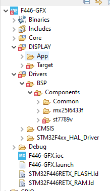

In the second image I can see some red crosses in the project explorer, but can't find any clue as to what they mean or how to resolve them.

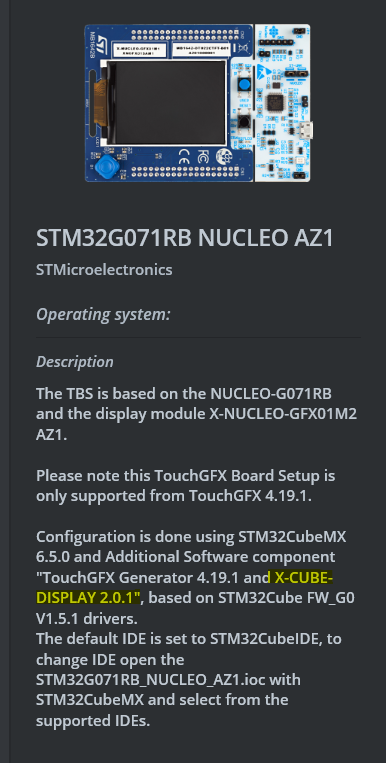

But If you think about working with TouchGFX Designer, we provide TBSs (TouchGFX Board Setup : preconfigured board with components) that have this X-Cube-Display integrated. So you might want to use them as inspiration. You could be interested in STM32G0RB NUCLEO AZ1 and AZ2 for example.
