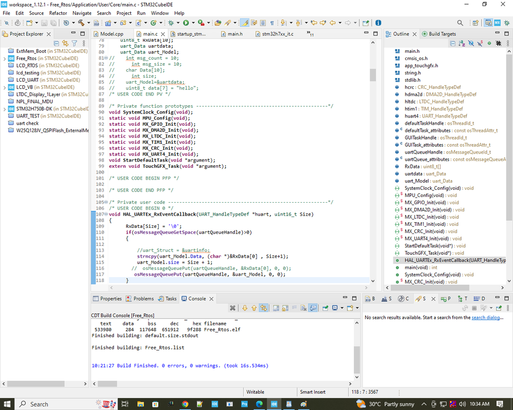

Hello @MM..1
I have made some changes still the problem is same but now it stuck in this line
configASSERT( !( ( pvItemToQueue == NULL ) && ( pxQueue->uxItemSize != ( UBaseType_t ) 0U ) )

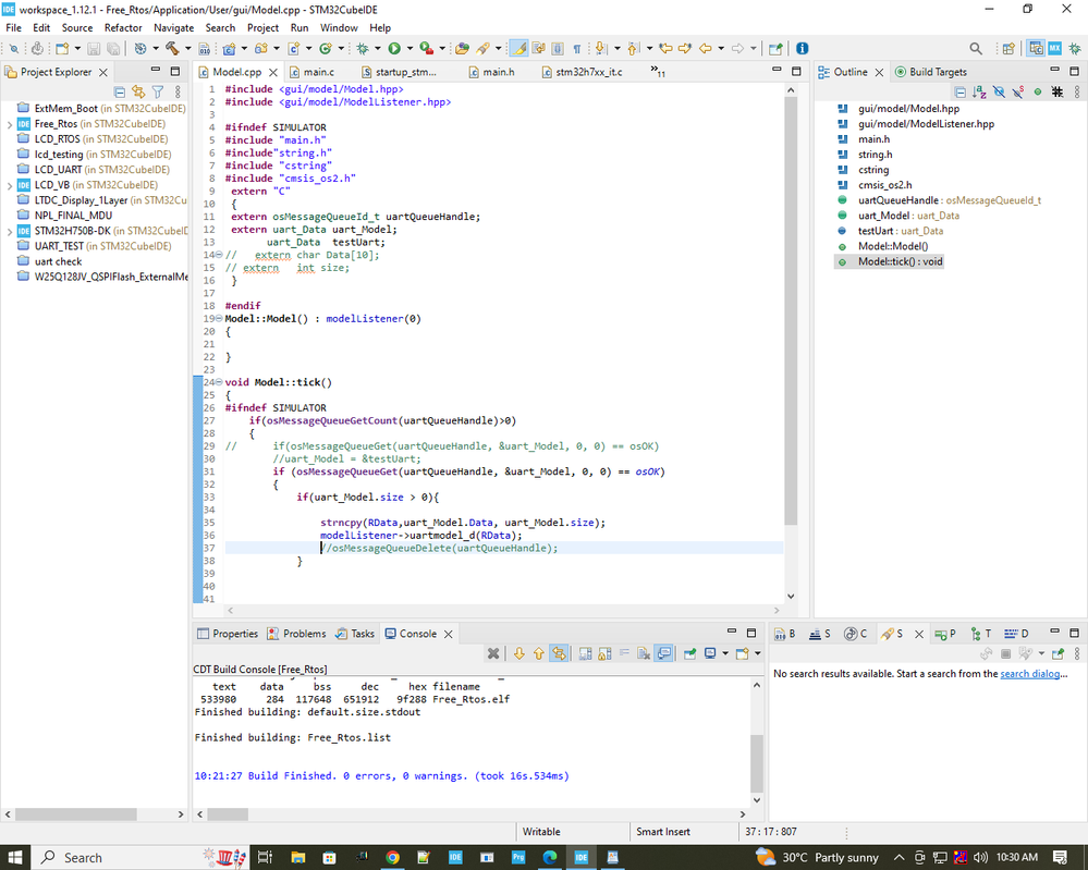

2023-07-12 11:12 PM
Please check once if I have done something wrong.
