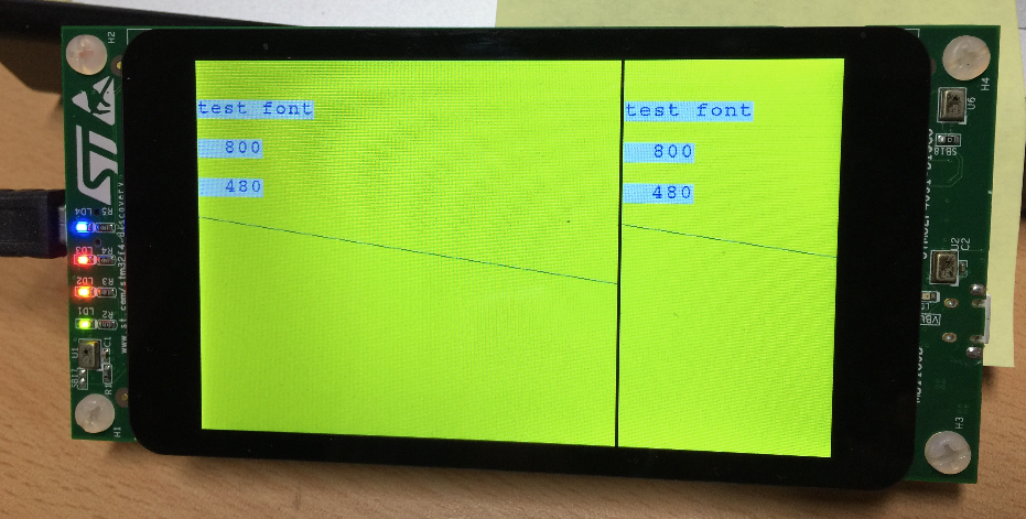

Create a new project using CubeMX, added some code and compile it.
the result is here.

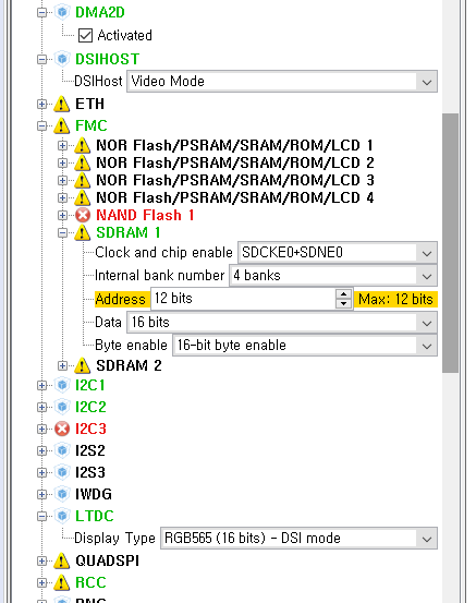

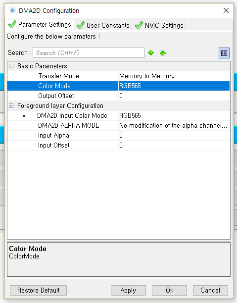

my CubeMX project configure is here.
No change is made to any configure LCD.

#469i #lcd #stm32469i2016-12-20 4:52 AM
Dear
SoHaeng.Lee
, You can refer to the LCD examples under STM32CubeF4 package to see their structure and configuration:STM32Cube_FW_F4_V1.0\Projects\STM32469I-Discovery\Applications\Display
Theworking example can help you about LCD configuration and programming the display.Look at these manuals :
, in '5.1 LCD configuration'section and . Hoe this helps you.Best Regards
-Imen-
