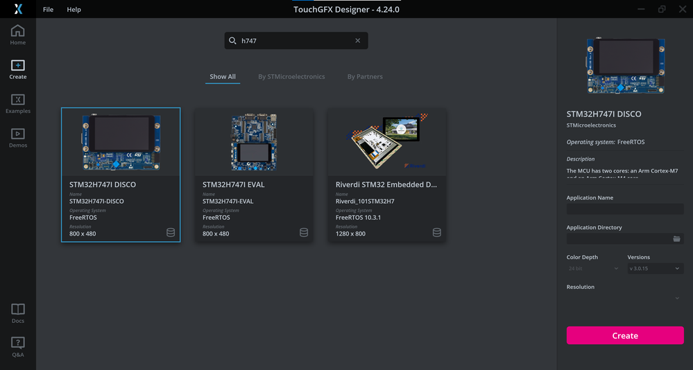

When you create a STM32H747I-Disco project from TouchGFX designer, you will have a project directory structure as below. Navigating through CM7->Core you can find main.c inside Src and main.h in Inc. Please, study the code and how the display driver is used before replacing it with nt35510.
STM32H747I-Disco TouchGFX Board Setup
Project Directory Structure
