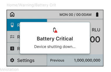

I think that might work if the modal were just a single screen, but the UI requirements is for it to pop up on top of the current screen, like this:
From your answer it seems the only way will be to the same on all screens?

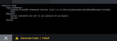

How can I run that project? I get :
