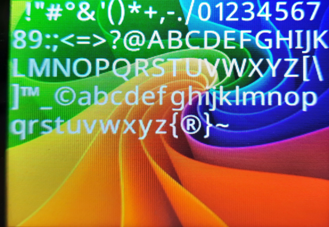

Note, ILI9341_SPI_PORT is a just definition in a header file for your display, i.e. ILI9341_conf.h, used to confgigure the display IO:
#define ILI9341_SPI_PORT     hspi4
In the code above, we only modify the DataSize of the SPI bus and leave the rest the same as when initally MX_SPI4_Init was called for example.
I have tried this for you, using an ILI9341 display, connected to a Nucleo-H7A3ZI-Q development board, and it works fine this way. You now do not have to loose time swapping bytes forth and back.
I added GPIO CS control too, in case you do it by software.
And never forget to set your window for the display.
You now can use DMA2D and nicely blend images.
Hope this helps.
0693W00000Hq9ruQAB.pngPhoto taken using my phone...
