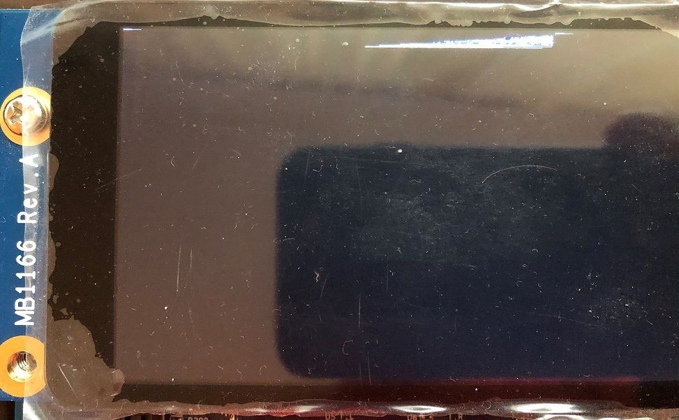

When I try to do some basic configuration of LCD with 769i disco, I see synchronization problems, that I could not proper image (attached image). LCD is dedicated B-LCD40-DSI1 board.

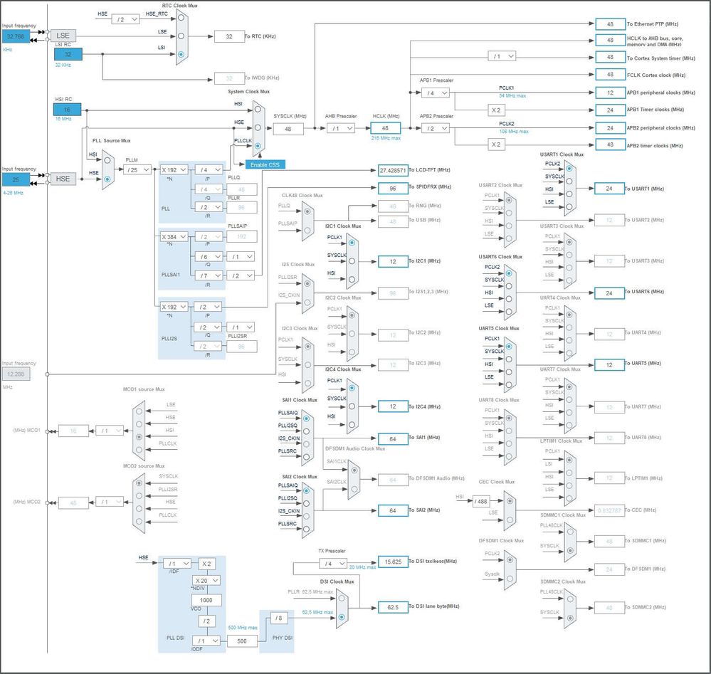

Below I am attaching clocks config.
2020-09-08 9:19 AM
I found the bug in the clock configuration. When I changed frequency to 216MHz it started to work properly.
