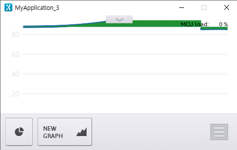

2019-11-04 3:29 PM
It is a problem when the following data is output from Demo Code.

};graphLine.setRange(-2, 216,120000,0);
The graph is printed but not normal.
2019-11-04 4:40 PM
like this.
2019-11-06 3:54 AM
Was it working with other ranges?
/Martin
2019-11-06 9:12 PM
hm....i tested max range 2000 it was good.
