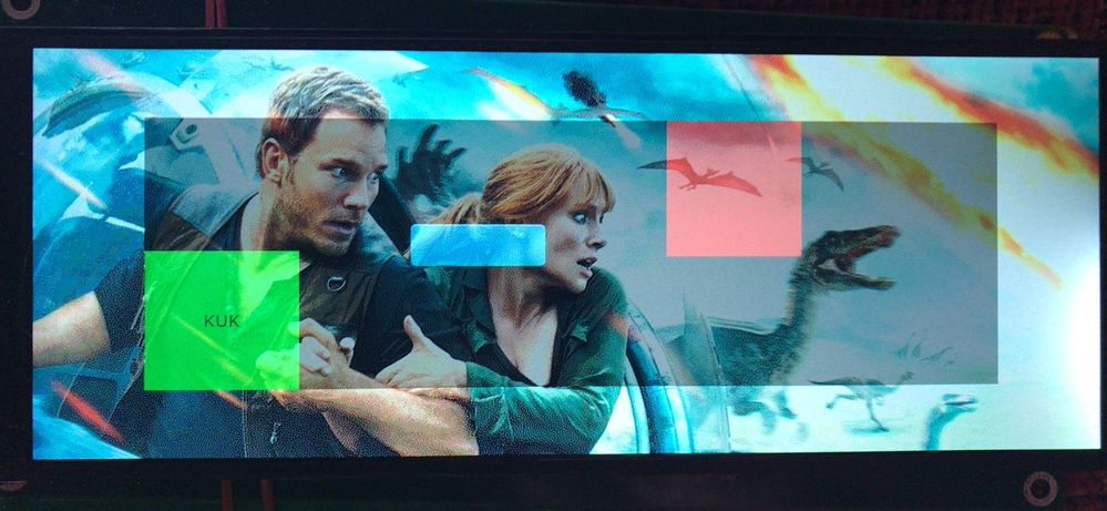

2022-02-18 4:39 AM
At 1 example 2 layer custom alpha used TGFX manage inner rect. I dont have MCU with keying feature, but setup keying can here maybe setup rounded rect or other effects as no full rect alpha ...
At 2 yes sometimes it is. This values is from display dataseets as describe page 7 table
