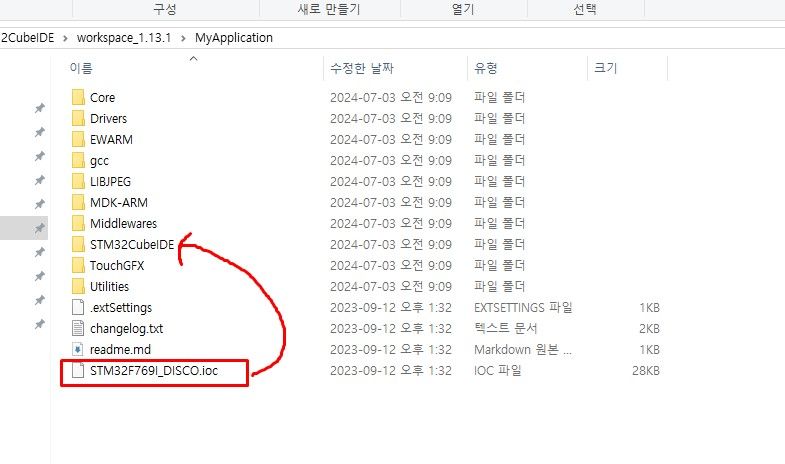

2. Move the STM32F769I_DISCO.ioc file in the project created above to the STM32CubeIDE folder in the project, then run STM32F769I_DISCO.ioc to additionally set IO and generate code.(below picture)
3. And when I compile the above project with the STM32CubeIDE compiler, an error occurs. These errors are too numerous to be easily resolved.

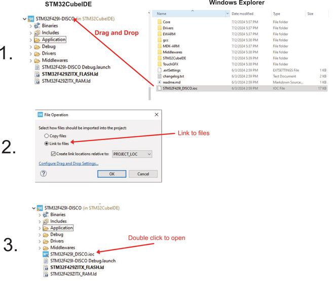

Don't move the IOC file and leave it where it was generated by TouchGFX.
1. Import the TouchGFX project into STM32CubeIDE. In Windows Explorer, just drag and drop the IOC file onto the project.
2. Select link to files and click OK.
3. Now the IOC files shows in the Project tree. You can double click it to open it. You can make your peripheral and I/O changes, then generate. It should build with no issues.

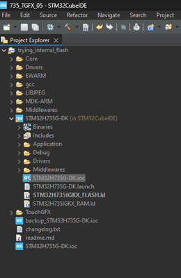

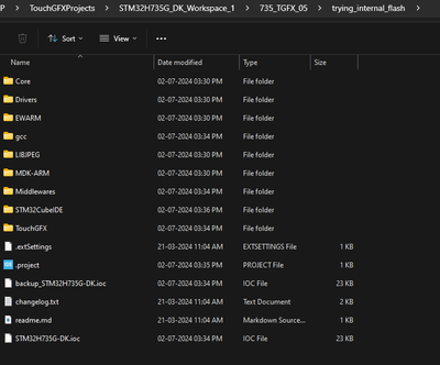

2024-07-02 9:48 PM

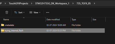

Assume "trying_internal_flash" is the project we created using the TouchGFX Designer, (the name we gave instead of MyApplication)
This will have files like this leave it as it is.

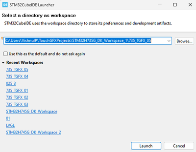

Now open the CubeIDE and open the 735_TGFX_05 as the working directory
Note : For each Project created using TouchGFX we need its own Working Directory, 2 touchgfx projects cannot be inside 1 directory becaus ethe name of the ioc file will be same,
Launch

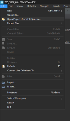

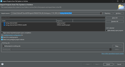

File -> Open Projects from file system
select the folder which is named after your project "735_TGFX_05\trying_internal_flash"
735_TGFX_05 is the working dir and trying_internal_flash is the project
Now it will open like this
