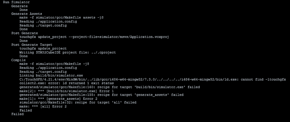

2023-05-18 10:27 PM - edited 2023-11-20 5:08 AM
I upload file in directory and get no error but now I can't run simulator:
2023-05-19 8:52 AM
Is the folder "C:\Users\martynasveit\Desktop\C7_2(20230226)\C7_SVN\Middlewares\ST\touchgfx\lib\win\mingw32" also empty, there should be file "libtouchgfx.a" ?
