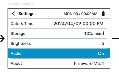

I've this screen requirement, a list of settings. I'm doing it with a custom container that I already created. My custom container has a flex button with text(on the left) + the text on the right.
What I need is that once the user presses the button, the text color changes to white. Once its released, changes back to black. The flex button works perfect, but I'm having trouble setting it up for the right text.
